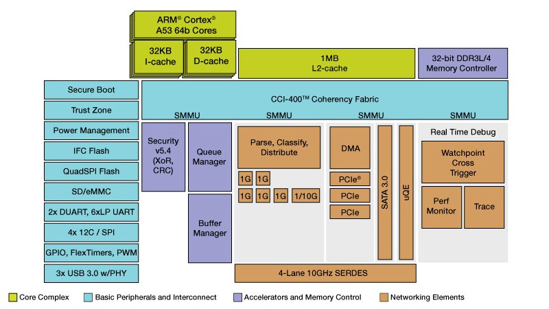

LS1043 Processor Block Diagram showing major feature blocks
LS1043A Processor Block Diagram (Courtesy of NXP) (Please note: Not all LS1043 features are available on the Five64 board).
