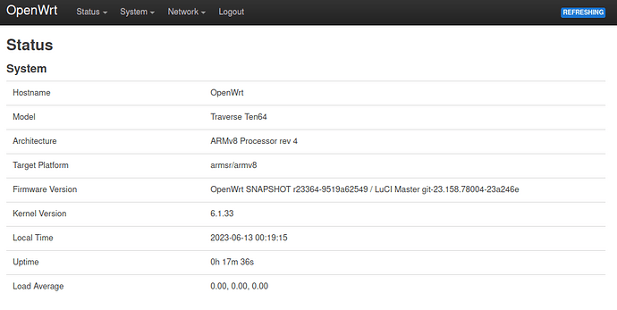

As of 2023-06-27, snapshot builds for Ten64 NAND are available, see the OpenWrt firmware selector.
The armsr target is only for disk boot, but a separate pull request has been opened to add Ten64-NAND to the layerscape target. These images will be compatible with the images built by Traverse. The NAND builds on archive.traverse.com.au will continue to be built on the (now) armsr target for efficiency reasons. You will still be able to move between our builds and OpenWrt.org ones. There are enhancements for NAND boot planned in upcoming firmware releases, so it’s not going anywhere.
The sysupgrade mechanism has been changed slightly the upstream version. If you upgrade, it will not correctly update the root= argument in the new GRUB configuration. I will see if I can backport the “new” upgrade support to the 22.03 builds. There are also issues with the different / partition sizes between Traverse and OpenWrt.org builds. It is on the TODO list to deal with this more gracefully.
Ten64 (disk boot) support falls under the armsr/armv8 target (Arm SystemReady => 64 bit (armv8) machines in the OpenWrt buildroot).
You can download them from https://downloads.openwrt.org/snapshots/targets/armsr/armv8/.
Keep in mind that OpenWrt.org builds (currently) don’t have LuCI or WiFi drivers installed by default. For example, you will need to run opkg update && opkg install luci.
