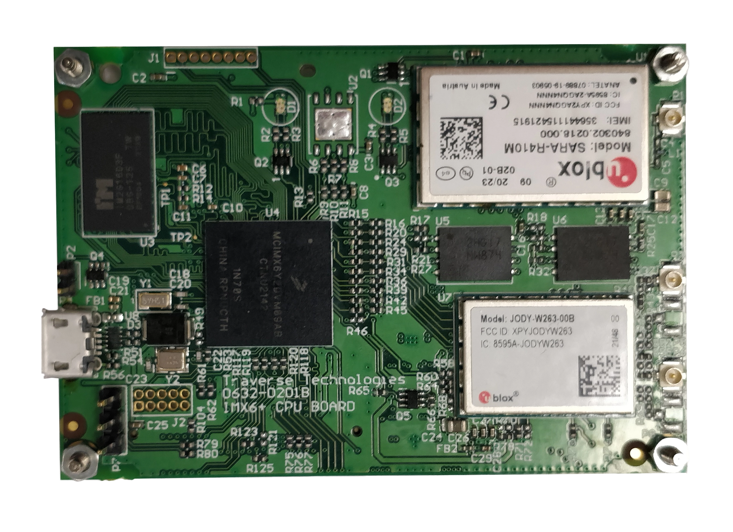

Traverse's iMX6 module provides wireless connectivity with WIFI, BLE, and 4G/LTE WAN. The i.MX6 IoT module is designed to be used with products such as IoT Gateways, Solar Inverters, Industrial Controllers or device that requires connectivity and management. Included in the module is a 32bit ARMSoC (System on Chip) that runs embedded Linux. A 60pin expansion connector enables wired interfaces, including Serial, MODBUS, CANBUS, I2C and Ethernet.
CPU | NXP i.MX 6ULL Cortex-A7 Core Single core A7 Cypto Engine (AES with DPA, TDES/SHA/RSA) Secure Boot |
External | USB 2.0 OTG Micro SIM 60pin expansion connector 2x 10/100Mbps ethenet Can Bus I2C 7 GPOI USB 2.0 |
Internal | USB Console port LTE Cat M1/NB U-Blox SARA WIFI U-Blox JODY eSIM |
Memory | DDR2 32bit RAM 8MB NOR Flash 256MB NAND Flash |
Onboard Peripherals | Real Time Clock (RTC) LTE supports Last Gasp OTA Reset Bluetooth BR/EDR and Bluetooth Low Energy (BLE) |
PSU | 5VDC OTG or 60pin Expansion |
Temp Range | 0 to 95°C |
Linux Kernel | 5.0 and later |
Linux Distributions | Debian, SuSE Enterprise Linux*, OpenWRT BSP available for other distributions on request |
Module | 70 x 48mm |
